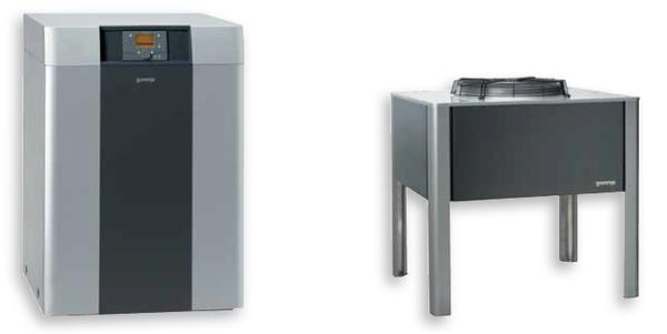

AEROGOR - AIR /water heat pumps
Air/water heat pumps make use of the energy stored in the air around us. They operate efficiently even at temperatures down to -20°C. Relative to other versions, less construction work is required and the equipment can be installed swiftly. The quality of make and cutting-edge technology allow high energy efficiency of these devices.
A silent axial fan pumps large amounts of air through the evaporator which is installed outdoors, separately from the heat pump agregat. Combination of evaporator and fan allow operation that is not disturbing for the environment, and generates high yields. Internal (indoor) heat pump unit is installed within the building. Such system prevents any freezing danger to the external unit even in cases of prolonged power supply failure. High-performance regulation allows running several heating circuits through outdoor temperature and provides optimum defrosting of the outdoor unit.
Heat pumps AEROGOR are ideal for use in bivalent systems with two heating sources and coordinated operation. The air/water heat pump consists of an indoor and outdoor unit. Three variations of outdoor unit are available: facade panel, metal sheet, and wood.
Heat pumps AEROGOR reach heatig power up to 12,2kW, rated power output 3,59kW and coeficient of performance up to 3,9.
